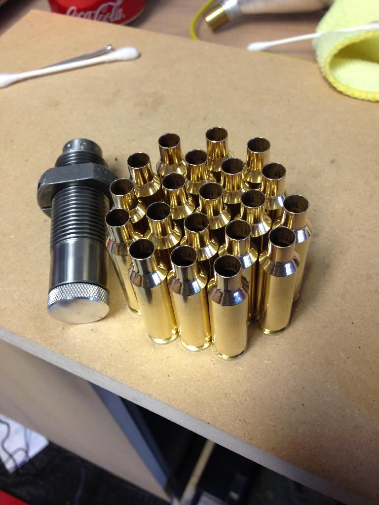

John. Lee Collet die + Forester = good combo.

Thats some shiny brass

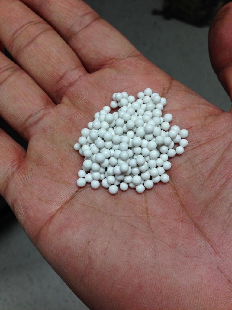

Ceramic media

How well does it do in the primer pockets?

not that well but it makes the outside look like jewelry.

Is it less fuss than STM?
